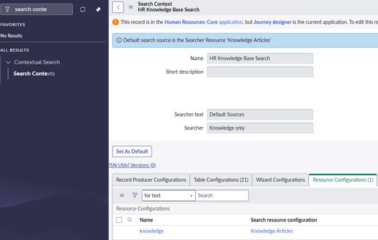

Go to "Search Contexts" and select "HR Knowledge Base Search":
Then open the resource configuration "knowledge":

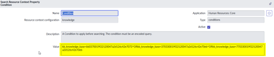

And now click on "Condition". There you can add a simple filter which Knowledge Base(s) to use:

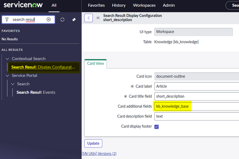

And, if you search in more than one KB, you might wanna tell your agents which KB the article belongs to.
For that, just configure the search result display:

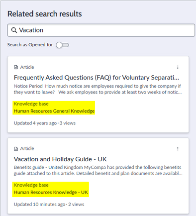

Then on the little cards the name of the Knowledge Base will appear:
