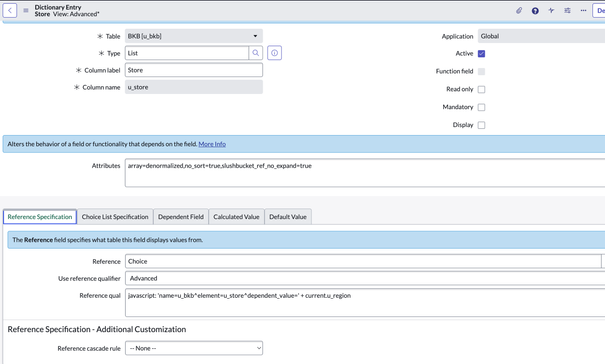

I'm trying to understand your setup to mock this up in my PDI so I can see what is happening.  Is the List table for store sys_choice?  Do you have a reference qualifier or Choice list?  If you could post screenshots of how each field is configured, that will help.

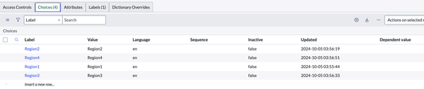

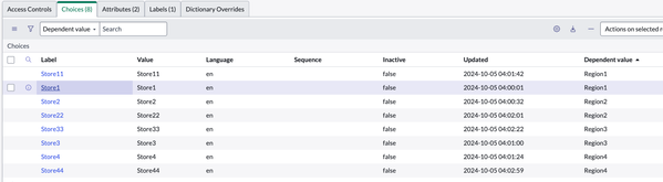

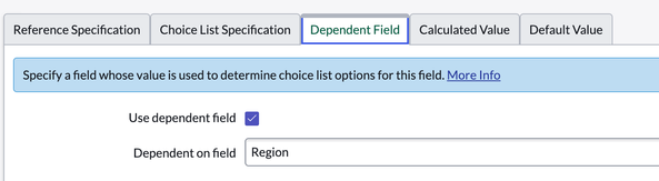

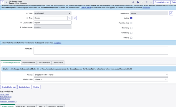

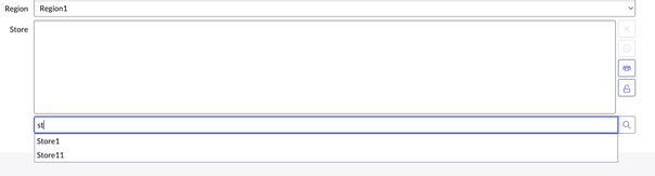

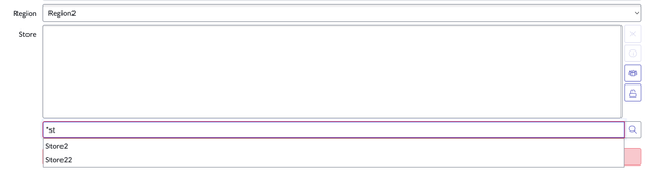

Here's how I have mine setup that seems to work.
I cant find the choice table in reference
