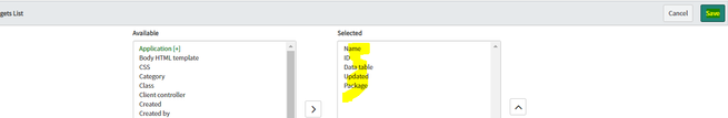

I am trying to create a new list layout but is not captured in update set.

Could you please explain the process how you are setting the list layout
Here is the process to setting the list layout:

I did the same process but is not captured.
Hi @Zuri ,
Make sure your Pre-requisites for the update set are correct:
1. Update set is "In-progress" and NOT in complete/ignore.
2. Make sure you are not capturing in the "Default" update set.
3. Clean the [sys_ui_list] table by removing the duplicate records and the ones with no Element.
Once, all of above is done , then you have to configure it via list layout --> right click on one of the column header then select configure List Layout. And do the necessary changes this will capture in update set.
