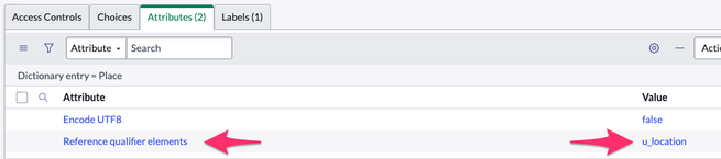

1. set the "Use reference qualifier" field to "Advanced" and the "Reference qual" field to "javascript:'u_area=' + current.u_location" (you might have to switch to the "Advanced" view if not already)
2. add an attribute to the field (at the bottom of the form) which tells the system to send back the value of the "Location" field so it can be used in the Reference Qualifier

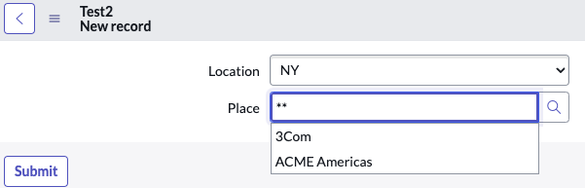

So now when you select a Location, only those matching Companies can be selected:
