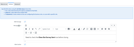

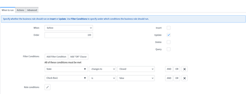

if you need to make Close Out Survey Sent field the before closing you can create before business rule and give the conditions and message as per requirement.
1. Give conditions as per your business need.
2. Check abort action on Actions section and give the message.
3. Result: It will show message like below when you tried to update without checking Close Out Survey Sent field.

This is the best solution so far, but the abort action does not work. The record is still closing.
‎02-13-2023 01:09 AM
Hi @Ruth Goodsell1 ,
Make sure your conditions are set properly. When your conditions are met then only abort will work.
