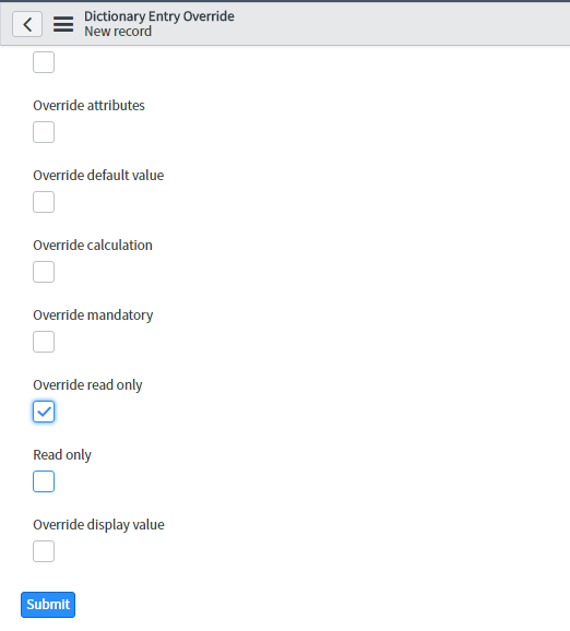

You can set read-only by Dictionary override for inherited/other fields, and changes will apply permanently.
The cons of using dictionary override is 'debugging' in case any issue occur.
If you want to apply read only for any specific role than I suggest write ACLs instead UI policy or dictionary override.

Dictionary override is not an option because a field on Product table cannot be override for the Story table (only shows the table that Product extends in the Story choice list).
