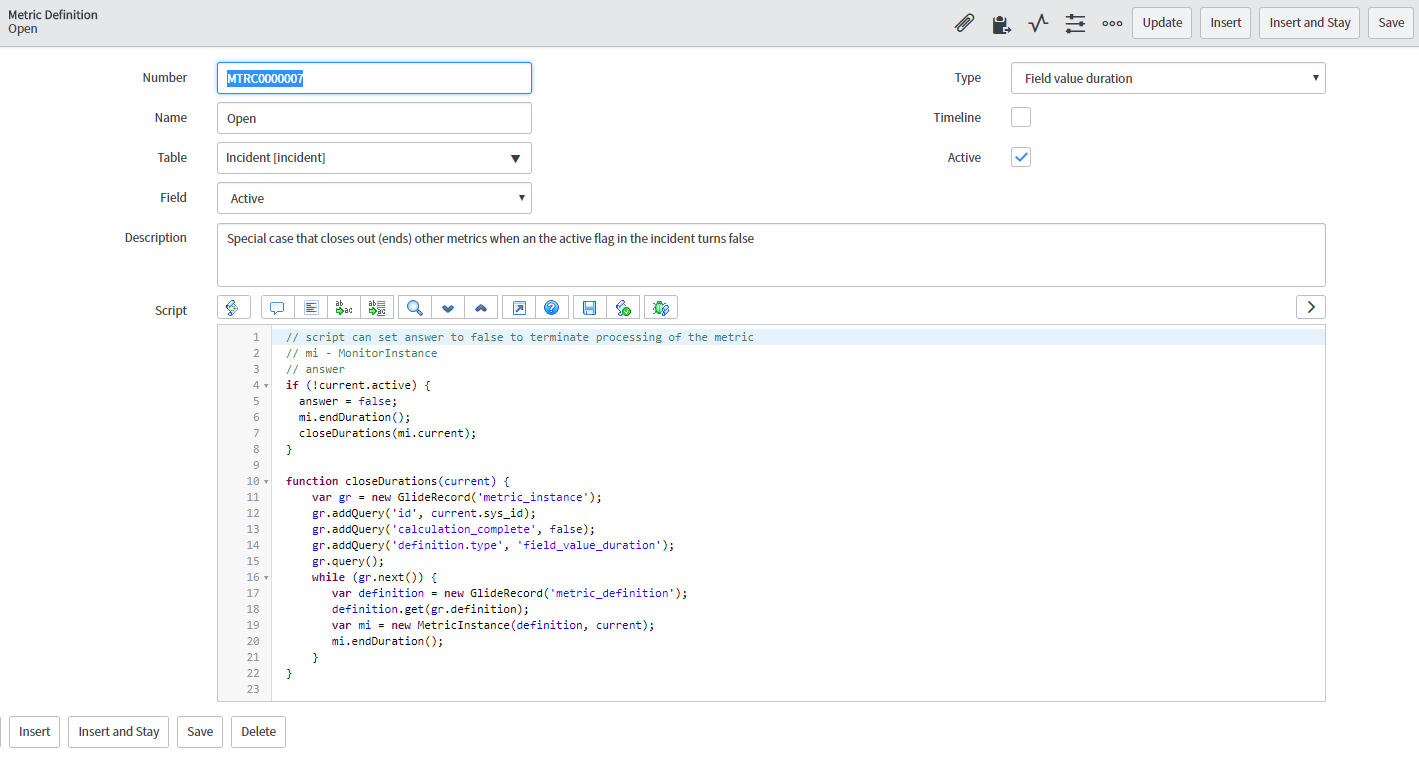

Carl Fransen1
Hi - this is probably a bit late but thought it couldn't hurt to reply.  I created a bunch of HR Metrics and these were also not closing off.  However I just copied the OOTB Incident one, which runs at an order of 10, so before everything else, and closes all metrics on inactive tables...
Screenshot of OOTB metric below.
Hope this helps someone!
Cheers
Carl.

@Carl Fransen
This script work when I am adding it to "Incident" table related Metrics. But not working for HR Case related metrics. Can you please help.
