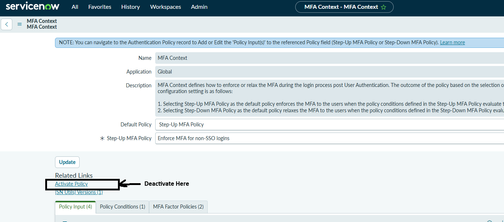

‎08-26-2026 09:30 PM
Okay But As far as I know, since the Authenticator app was reinstalled, the existing authenticator setup may no longer be available. In that case, you would need to either recover the existing authenticator setup or somehow access the PDI and temporarily disable MFA to complete the enrollment again.
Additionally the MFA policy also needs to be deactivated in the Multi Factor Authentication > MFA Context so that you can access the instance and complete the authenticator enrollment again.
