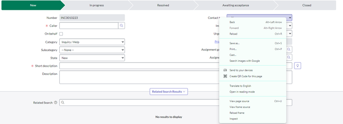

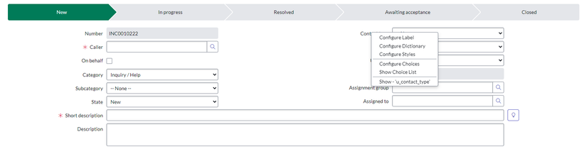

I just encountered a problem, creating specific incident form (based on criteria) and continuously building up (UI actions, Business rules, etc.). Now I wanted to add some Client Scripts+Script Include, but the incident form became "non-interactive" in a way, that I couldn't use magnifying glass to look up references, no recommandation while writing a user's name and such. Only fix was to disable Client Scripts+Script Include (even if I did only Client Script, it was causing the same issue). I tried to handle this via chatgpt, which just pointed me towards "missing HTML" element.

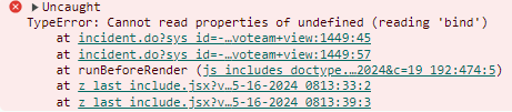

Only error I found was this.

Thanks a lot. I found out, it was causing this "function" at the top. I deleted the first lines and belonging brackets and it works now.
