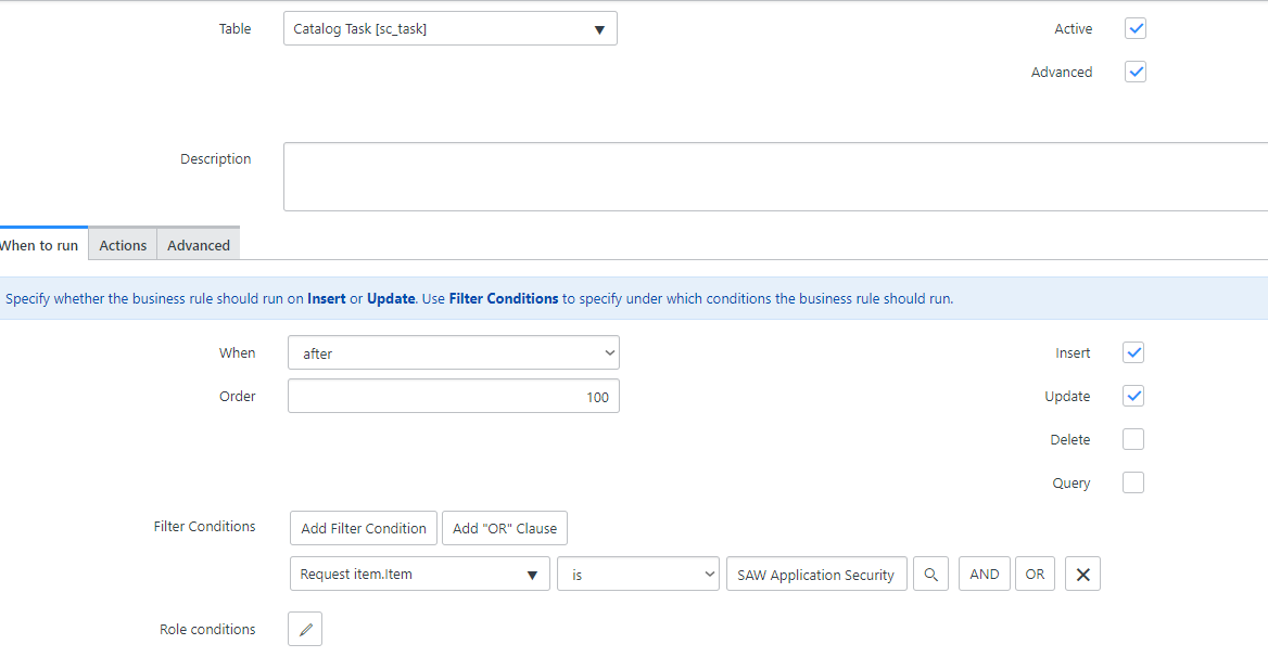

I changed the BR to the code above, and also set the condition as you suggested, but it is still not working. Since I changed the condition should I remove this part since the condition is already doing that for me?
if (item.cat_item == '3c8f73a7db669f04dc05546adc96194b')
Here is what I have now:
I tried removing the if statement and that didn't work, I also added the condition Work Notes Changes and still not pushing the task work notes to the RITM work notes.
