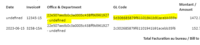

I created this email script to read the information from my MRV to be added to the email notification.
However, in my MRV i have three reference fields that when i submit the form will only display their sys_id.
How do i get to display their actual values on the email script.
here is the code i am using:
var record = new GlideRecord('sc_req_item');
var sysCurrentRecordSysId = current.sys_id;
record.addQuery('sys_id', sysCurrentRecordSysId);
record.query();
while (record.next()) {
var obj = JSON.parse(record.variables.bill_to_office_mrv);//mvr name
for (var k = 0; k < obj.length; k++) {
' + obj[k].office_office + ' - ' + obj[k].department_office.getDisplayValue() + ' //Office & Department field you see in the pic above
' + obj[k].gl_code_office + ' // gl code
i tried using the .getDisplayedValue() on the department and it comes back with undefined.
any help is appricated here

You have to lookup the records in the appropriate tables and get the records display value.
06-08-2023 11:28 AM
office is referencing to the cmd_location table
department is referencing to the cmd_department table
Gl Code is referencing to a custom table called u_gl_code
06-08-2023 11:28 AM

06-08-2023 11:32 AM
i have tried both and they are returning undefined
' + obj[k].office_office.getCellDisplayValue() + ' - ' + obj[k].department_office.getLabel() + '
