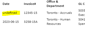

I created this email script to read the information from my MRV to be added to the email notification.
However, in my MRV i have three reference fields that when i submit the form will only display their sys_id.
How do i get to display their actual values on the email script.
here is the code i am using:
var record = new GlideRecord('sc_req_item');
var sysCurrentRecordSysId = current.sys_id;
record.addQuery('sys_id', sysCurrentRecordSysId);
record.query();
while (record.next()) {
var obj = JSON.parse(record.variables.bill_to_office_mrv);//mvr name
for (var k = 0; k < obj.length; k++) {
' + obj[k].office_office + ' - ' + obj[k].department_office.getDisplayValue() + ' //Office & Department field you see in the pic above
' + obj[k].gl_code_office + ' // gl code
i tried using the .getDisplayedValue() on the department and it comes back with undefined.

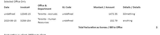

I am almost there, so far i have the Office and departments working
But now the date in the first field is getting undefined and the GL Codes is still showing as undefined.

06-08-2023 01:06 PM
found the issue
while (grDep.next()) {
should be
while (grGl.next()) {
however the date in the first one is now displaying as Undefined but the second one is fine
06-08-2023 01:37 PM
You can also do it like this, its a bit less typing
var glCode1 = "";
var grGl = new GlideRecord('u_gl_codes');
if(grGl.get(obj[k].gl_code_office))
glCode1 = grGl.u_gl_long_desc;
