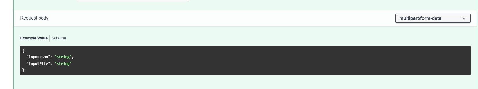

I have a requirement to send a multipart request having an input Json and input file. The input file is a compressed zip file in ServiceNow and expectation at third party is to have type string and binary format for the file as in screenshot. Also, the testing from Postman is successful as it allows a direct upload of the file from system. Is this feasible from ServiceNow and will the file content have any issue being compressed zip file?
Please help with the script/approach for this if feasible

You can use below code to send attachment in binary format -
var sa = new GlideSysAttachment();
                var StringUtil = new GlideStringUtil();
                //Get the base64 encoding of the attachment
                var binData = sa.getBytes(singleattachmentsysid);
                var encData = GlideStringUtil.base64Encode(binData);
Now for multiple just add loop.
i hope this answers your queries.
