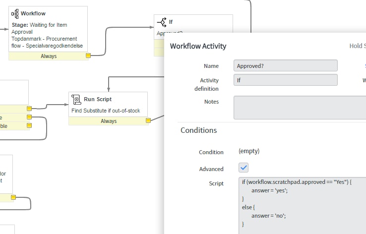

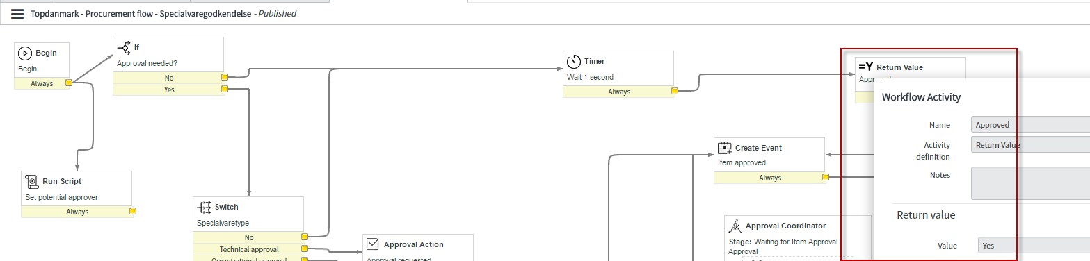

You won't be able to apply an extra workflow to all of your items, as the workflow is controlled by the "workflow" field on the catalog item form.
You can however make on "approval workflow" and call it as a subworkflow in all the workflows you use for items which need this approval. The subworkflow can also return the approve/reject result and you can react on that.
This also means that you only have to modify the subworkflow once to adjust the approval process
http://wiki.servicenow.com/index.php?title=Using_Subflows#gsc.tab=0
I use it for all of our items which involve ordering of Assets. We have a bunch of workflows using the same approval process, which run in a subworkflow
1. Use the "Return Value" activity to return the result in the subworkflow
2. Map the result of the workflow to the scratchpad
3. Then process the answer - here i do it in an If
