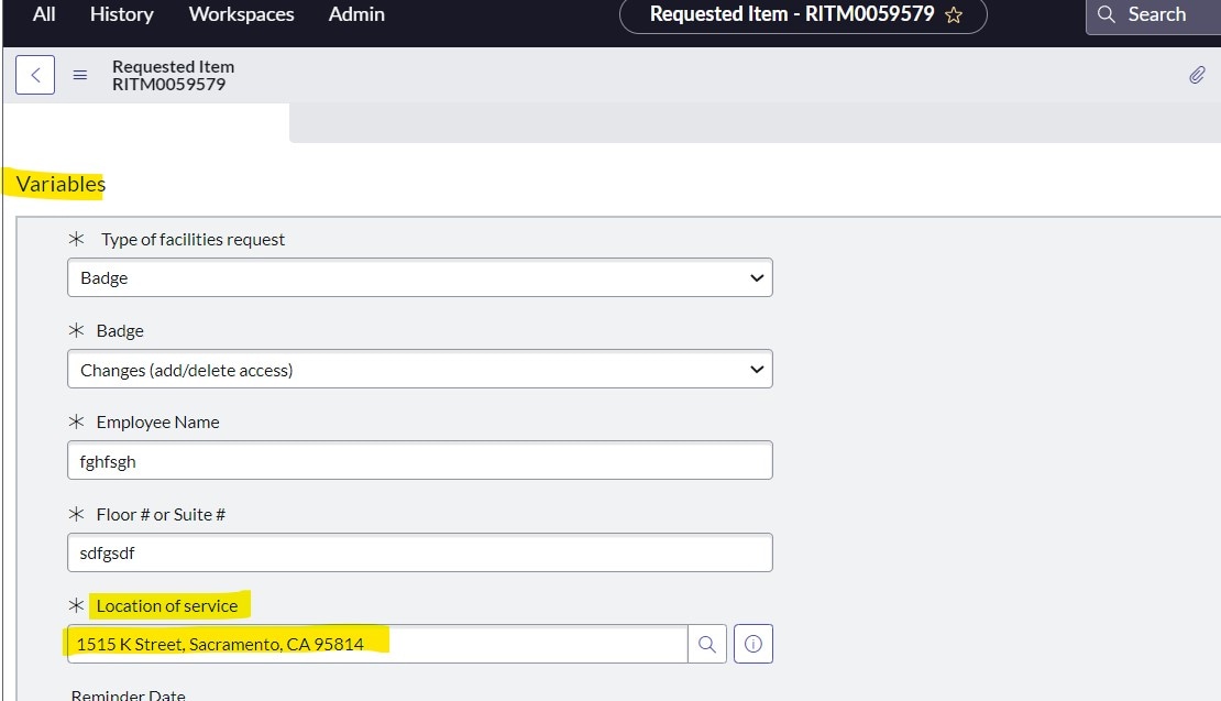

I created a variable call "location of service" and when I am looking at the list view I want to be able to see the location information from this field. I currently have it mapped like this in the workflow task and still not seeing the variable information in the list view.
current.request.location.location = current.variables.location_of_service;
task.request.location.location = current.variables.location_of_service;

Where do you want to store the location from the variable? On what record and what field? For me, task.request.location.location and current.request.location.location do not make sense. If you are setting location on the task, then I would use task.location; if on the requested item, then use current.location; but if you're trying to update the request level - first, this is questionable. Request can contain multiple requested items, so you could have conflicting information on that location from different requested items. But, if you need the location stored at the request level, you need to gliderecord query that request and do a .update on the record to update its values.

I'm basically just trying to see a variable "location of service" information under the RITM and SCtask "list" view for Location. I've done it for other variables but it's not working for this field not sure why?
04-11-2023 02:05 PM
So, to target the RITM's location field, you just need current.location; for the task task.location.
