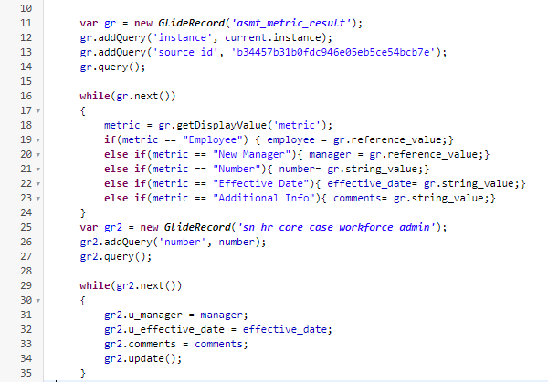

2. Create Business Rule on Table: asmt_metric_result
  • Before
  • Conditions: source = 'My Survey ID' & metric = 'Number'
3. On Advanced Script,
  • pull 'current.instance' and run a GlideRecord lookup on asmt_metric_result table for all records that match that 'instance'.
  • In the while loop, I performed a check on the 'metric' field to see which field it was, and mapped it to the 'reference_value' or 'string_value' fields accordingly
  • Finally, I created another GlideRecord to Update the data on my case table.
