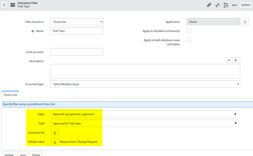

I have been spending many hours trying to get the interactive report filter the correct data. As of now, I'm still could not get it right.  I only want to displays "Request Item" and "Change Request" from the dropdown list. Thank You
Here is the screenshot of the Interactive Filter:
However, I keep getting all records returned:

Hi @Radhika11 ,
Here you are trying to apply filter on a field of referenced record (Task Type is field in Task Base table). In this case custom filter using Content Block is the way to achieve your requirement. I simulated your requirement and found the solution. Follow along to achieve your requirement.
Dashboard:

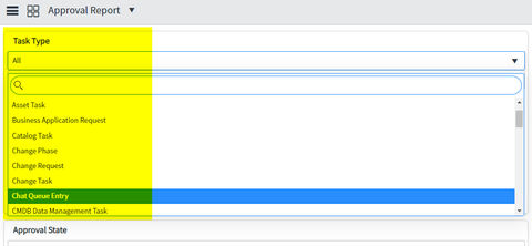

Created a Dashboard with 3 widgets,
  1. Content Block - Dynamic Filter
  2. Interactive Filter - Choice List
  3. The Report - Approval table
In a Dashboard, Click on Add widget, then select Widget Category as "Content Blocks" and Select "*New Dynamic Content" then click on "Add".
Once the widget is added to dashboard click on "Click Here to configure this reusable Dynamic Content Block" as shown below.
In the new Dynamic Content record form fill in the name as "Approval Task Type" and the "Dynamic Content" Script field with the following script and save the form.

2. Interactive Filter - Choice List:
Now create a Interactive Filter of Choice List type as the one below and add to the Dashboard.
3. Create a Report: I created a report on approval table like the one below and add to the form.
After adding the report to the dashboard, click on Edit Widget (Gear Icon) of Report, then Enable interactive filter.
That's It!!
