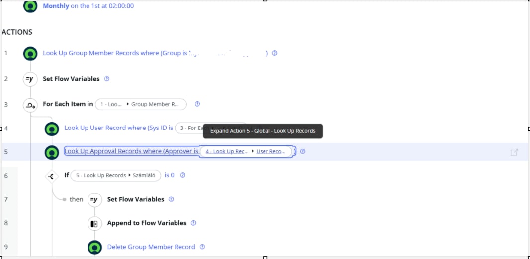

I'm working on a ServiceNow Flow Designer requirement and would appreciate some guidance on the final part of the solution.
Requirement
  1. Run a scheduled flow every month.
  2. Check which members of the "Finance Group" have not been selected as an approver in the last 6 months.
  3. Remove those users from the "Finance Group".
  4. Send a notification email listing all users who were removed from the group.
Current Progress
I have successfully implemented most of the logic:
  • The flow identifies users who have not been used as approvers in the last 6 months.
  • The users are being removed from the group as expected.
Challenge
The issue I'm facing is with the email notification.
I have a For Each loop that iterates through all eligible users (currently around 22 records). During each iteration, the user is removed from the group and I get the corresponding user details.
What I'd like to achieve is:
  • Store the details of every removed user during the loop execution.
  • After the loop completes, send a single consolidated email containing:
    • Total number of users removed.
    • List of all removed users.
What I Have Tried
I attempted to use:
  • Set Flow Variable
  • Append to Flow Variable
However, I'm unable to successfully accumulate the user details across all iterations and use them in the final email notification.
  1. What is the recommended way to collect values from each iteration of a For Each loop in Flow Designer?
  2. Should I use a String flow variable, an Array flow variable, or another approach?
  3. How can I build a consolidated list of removed users and reference it in a single email after the loop completes?
Any examples or best practices would be greatly appreciated.

With flow designer you will be able to achieve the deletion however will not be able to generate one consolidated e-mail because of "for each" loop.
Hence, my recommendation is to create a Flow Action with Script Step as shown below:
