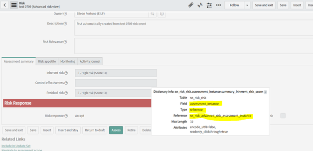

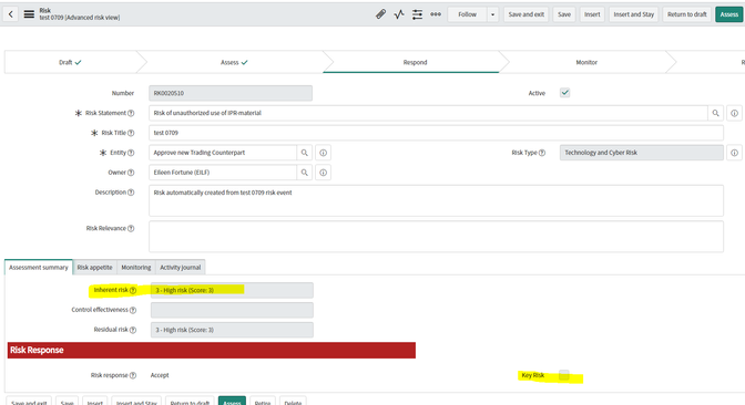

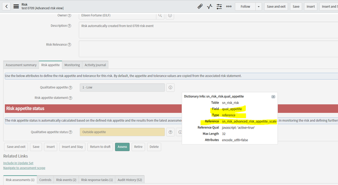

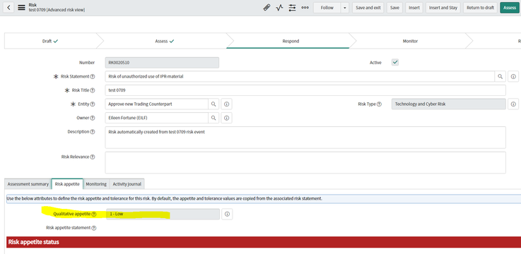

On Risk(sn_risk_risk) form, I have 2 dot walked fields 'Inherent Assessment' and 'Qualitative Apetite'. I have to fetch these 2 values and compare them.
Condition is : If Inherent Assessment > Qualitative Apetite, We need to set the flag true.
Inherent Assessment field is from Table - sn_risk_advanced_risk_assessment_instance
Qualitative Apetite filed is from Table - sn_risk_advanced_risk_appetite_scale

I do not have this module active so cannot show you directly, but create a business rule on the [sn_risk_risk] table make it onBefore on insert and update (mark Advanced true), and use script something like this (it must be played with, this is very drafty I just shot untested):
var reference1 = current.sn_risk_advanced_risk_assessment_instance.getDisplayValue();
var reference2 = current.sn_risk_advanced_risk_appetite_scale.getDisplayValue();

You said that the value is to be compared, not the sys id, right? ALso, I do not know the exact Key Risk field name... avoid using update() in BR...
