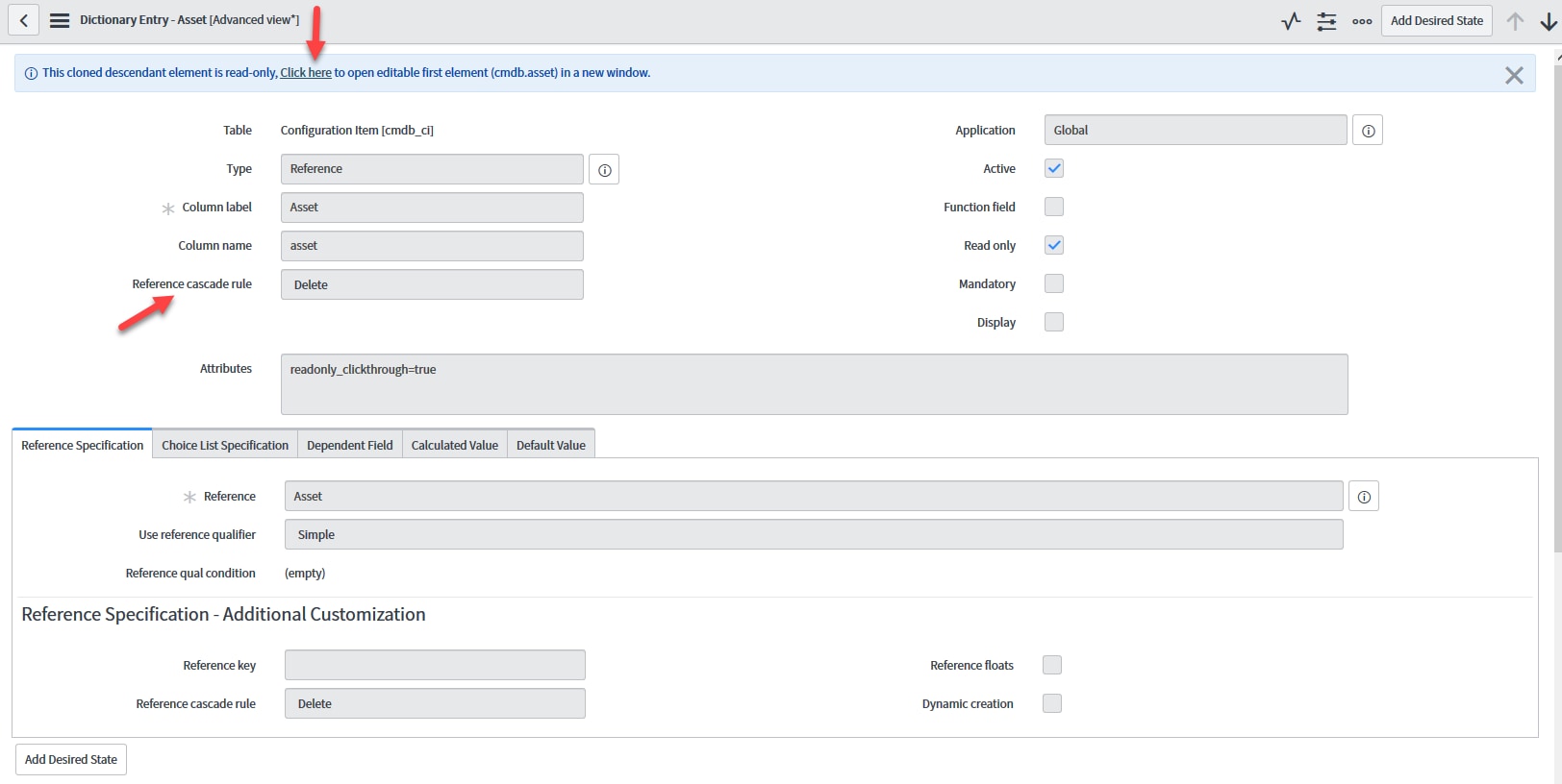

‎10-26-2018 01:28 AM
Go to cmdb_ci dictonary and open Asset field, then add Reference cascade rule field to the dictionary view, its default value should be Delete, change it to None temporarily and save it.
Delete the necessary assets and change Reference cascade rule to Delete again afterwards.

‎10-29-2018 01:07 AM
Hi Joaof,
Thanks for your response. I tried to edit the reference cascade rule on cmdb_ci table but it redirects me to CMDB table. Should I proceed with it?
