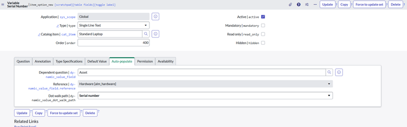

I am working on one of the form in this form, I have Asset field it is referring to alm_hardware table and I have one more field called Serial number it is single line text.
My query is When I select any asset on the "Asset" field I need to populate the Serial number of the the respective asset on the "Serial Number" field.
Please any one provide me the input.

Hi @vinuth v ,
Open the variable configuration of the "Serial Number" field, in the Auto-Populate tab add the dependent question as Asset and in the Dot walk path - select serial number.
