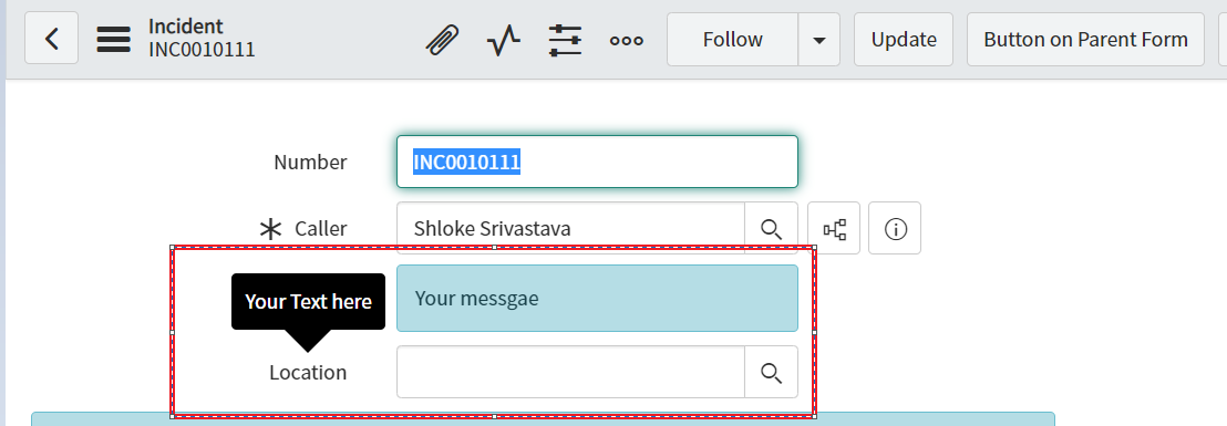

okay which is strange I believe. Do one thing put a alert and debug if client script itself is getting executed or not.
So put a alert in first line before line number 4 in your client script shown above as below:
function onLoad() {
alert('Script executing');
g_form.showFieldMsg('caller_id','Your messgae','info');
Screenshot attached for reference:
Also try explicitly checking for new record as below if above does not works and see if you get it through or not:
function onLoad() {
if (g_form.isNewRecord()) {
g_form.showFieldMsg('caller_id', 'Your messgae', 'info');
For me both the scripts works.

Do one thing try showing the Field Message for some other field say Caller(caller_id) and see if message is coming or not.
This way we can eliminate one scenario if there is an issue with this script or something else.
Also remove the annotation in yellow and then try with your script again.
Shloke

Also would like to add you can add a Help Text on the Field you need by Right click on the Field and then select Configure--Label
Then add the Help text you need as shown below:
Result:
So when some one hovers on the field the message will be displayed.
