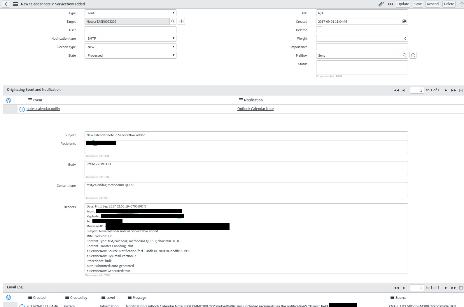

Ok, so I'm trying to send out a meeting invitation from ServiceNow (currently Helsinki) and I've read the guides ( ServiceNow Calendar Invites ) and done all the parts as far as I know. When ServiceNow is sending me the calendar invitation the file name is "not supported calendar message.ics" and is only 16 byte small containing something like "Ref:MSG0194832"
I found this topic and looked through it How to configure Meeting Invitation to Outlook? but even though I have done all things in that post I still get the same failing calendar invitation. I'm running out of ideas and was wondering if anyone here might have a clue on what the problem might be.

Fig. 1 - Email notification
Fig. 2 - Import Export maps
Fig.3 - Email log
Fig.4 - Notes table extended from Task
Let me know if you see anything obvious issues!

Hi Michael! I just wanted to give you feedback on the issue I was having.
Apparently ServiceNow demands that the meeting invitation has to be sent through a email template in order to not get the "not supported calendar message.ics" message.
