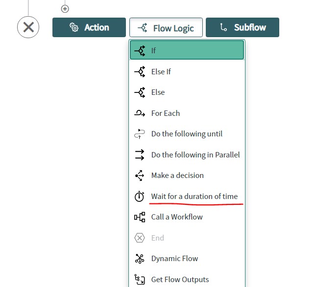

Hi Ashutosh,
I could not find the wait condition, I can only select wait for the condition. How do I set the timer condition?
When you click on plus sign then you see flow logic and in that flow logic you see wait for a duration of time and that is what you should use.
Ashutosh
