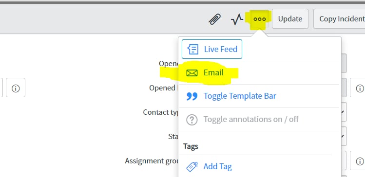

Email notification has been triggered, but no. email log attached, how can we find from where the notification has been triggered
12-23-2020 09:16 PM
Thanks everyone for helping. Finally I have found why there is no logs for the emails.
Users are sending emails from the form itself, so there are no email logs in the notifications already triggered.
If emails are triggered from this method email log will not be attached to the sent email.
