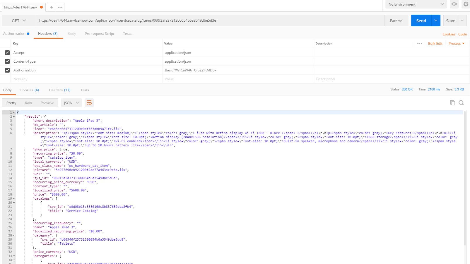

Hi William,
Using postman i sent in a request to retrieve the item details with the following details:-
URL   for Get Request   -   {URL}/api/sn_sc/v1/servicecatalog/items/060f3afa3731300054b6a3549dbe5d3e
Replace URL with your instance url
Then added the following headers
Accept application/json
Content-Type application/json
Then added Basic Authorization with user name and password for authentication, once you do that please press the Update Request Button in postman so that it adds a third header called Authorization with a value once you have added the basic auth details. Please ensure the user whose auth details you are entering has the read access to the record.
Now sending the Get Request would fetch you the Item details only. I was able to verify this in Postman.
Venkat,
That failed in my instance so I spun up a developer instance and repeated the setup and was successful. My instance is on Helsinki and the developer instance was Istanbul. The documentation suggests this is supported in Helsinki but maybe I'm wrong on that?
