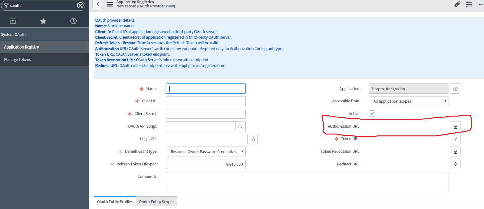

1] Create oauth profile in oauth -> application registry , we mention authorize API here (please find the screenshot)

3] Now when we hit "Get OAuth Token", service-now redirects with following URL
https://our_authorization_server/oauth2/authorize
?&response_type=code&redirect_uri=https://dev1234.service-now.com/oauth_redirect.do&client_id=1234585885869459430303003
Please note : service-now has appended & before "response_type" parameter which is causing our parsing to fail.
