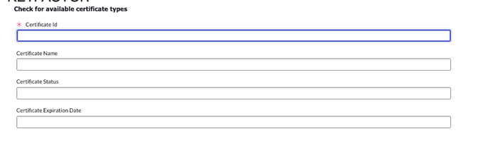

Trying to create an onChange ServiceNow catalog client scripts that update variable fields based on external REST API data.
The fields should auto populate after entering a certificate ID number. The response should include the Common name, Status and expiry date of the certificate, which is based on the certificate ID entered on the field

The catalog item form
Tried the above script but nothing happens... help needed please

Oh nice, that seemed to show the respected backend field data, i get all the results;
But the catalog item variable fields are still not populated (empty)
