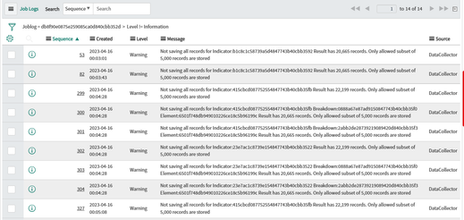

I have designed PA Report.
 In the graph it is showing correct number of records are:20,665.
But in list view it is showing only 5000 records.
While running the job there are some errors below is of the error.
Not saving all records for Indicator:b1c8c1c58739a5d4847743b40cbb3592 Result has 20,665 records. Only allowed subset of 5,000 records are stored.
Can anyone tell me where i need to change the setting for increasing the count of limit records to display in list view.

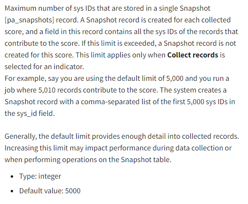

Uncle Rob
DOCS:  Performance Analytics Properties
com.snc.pa.dc.max_records
Bert_c1
Try the system property named 'com.snc.pa.dc.max_records'
