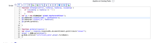

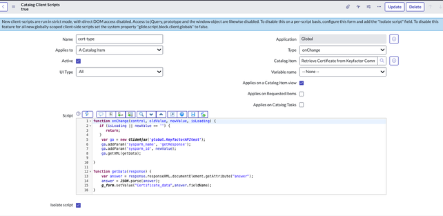

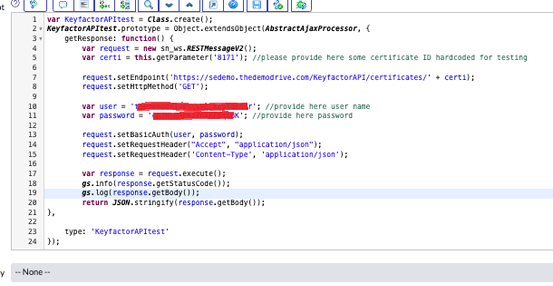

04-14-2023 05:57 AM - edited 04-14-2023 06:22 AM
created the below Script include;
Client Script;
But nothing shows on the catalog item;
also to add i am applying the script under on the Catalog Item Client Script ;
