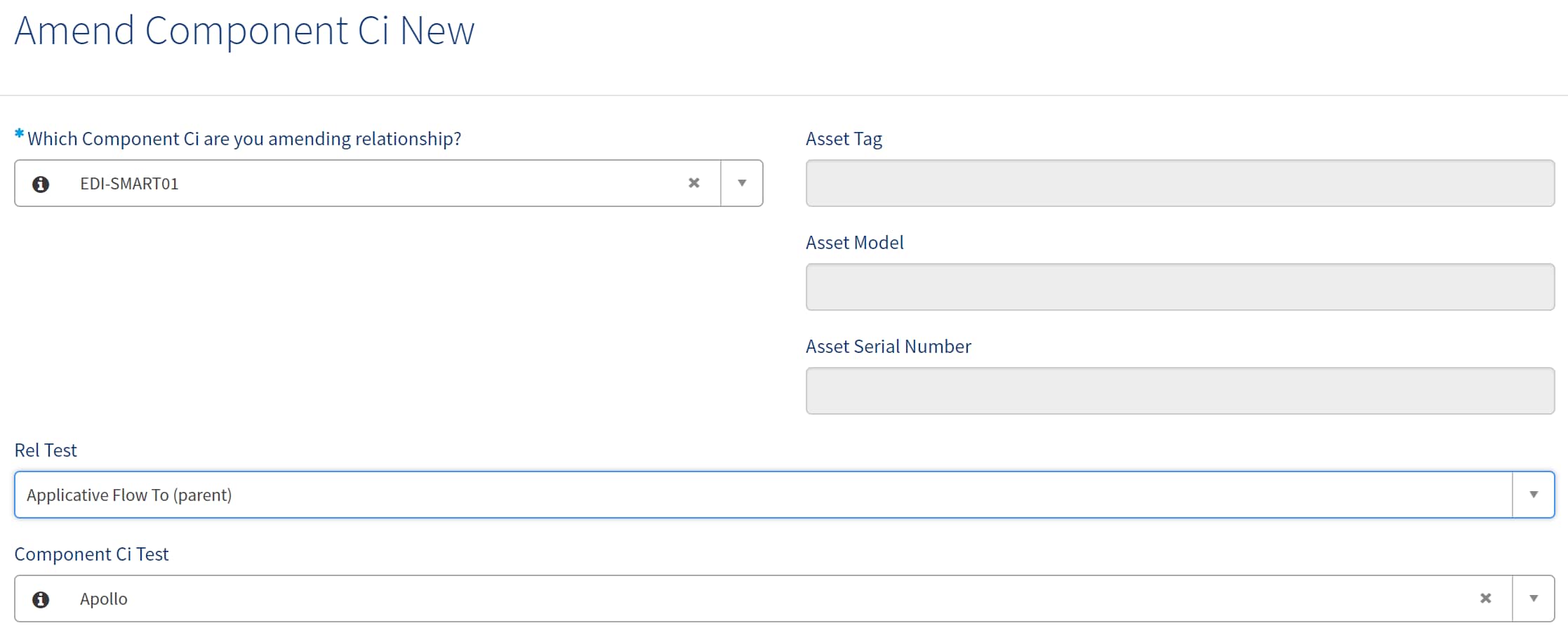

Thank you for getting back me I really appreciate it. I tested with your code line change and this did not work. Let me demonstrate visually what I am after. This is how things work right now with the following Client Script:
On the form when I change 'Which Component Ci are you amending relationship?' the Client Script Runs and 'Component Ci Test' is populated:
 What I would like to happen is the following:
You select something from 'Which Component Ci are you amending relationship?' and then you select 'Applicative Flow To (Parent)' from 'Rel Test' then and only then will it run that particular Client Script when 'Applicative Flow To (Parent)' has been selected along with something in the 'Which Component Ci are you amending relationship?' variable. So it would end up looking like this:
I hope that makes sense?
The Client Script is configured to run onChange of the 'Which Component Ci are you amending relationship?' however I don't want it to run unless 'Applicative Flow To (Parent)' has been selected in the rel_test variable.
Just to confirm Which Component Ci are you amending relationship? = amend_ci
