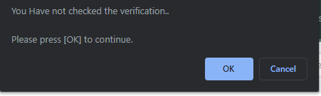

If a User doesn't check the checkbox then on Submit of catalog request I need to display an alert.
if the user click on OK then request has to be submitted, if the clicks on Cancel then he has to stay back on the form.
With the below script, in both the case form is not getting submitted.

Try this.
function onSubmit() {
var checkboxResponse= g_form.getValue('chkbox_verify');
if(checkboxResponse=='false' || checkboxResponse== false ){
var val=confirm("You Have not checked the verification..\n\nPlease press [OK] to continue.");
if(val){
//request has to be submitted.
return true;
else{
g_form.setValue('chkbox_verify', false);
return false;

‎06-26-2020 04:09 AM
Checkbox always return true value,
var checkMod = g_form.getValue('u_modify_text')); //checkMod is true if u_modify_text is checked, false if unchecked
if (checkMod){

try this script.
if(checkboxResponse=='false'){
if(val=='true'){
return true;
else{
//Stay back on the form.
return false;
Dhananjay.
