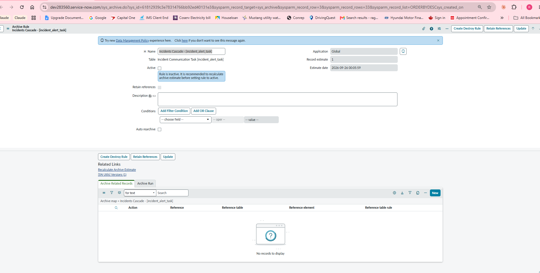

This looks like a configuration Issue not a bug. I was able to replicate this scenario in my PDI  and was able to sucessfully archive incident--->incident_alert--->incident_alert_task  tables
I created 3 rules just like you did mention on your post (refer main screenshot attached)
Archive Rule 1: "TEST - INC0000060" (Active)
Archive Related Record:
  • Action: Archive
  • Reference: incident_alert.source_incident
  • Reference table: Incident Communication Plan [incident_alert]
  • Reference element: source_incident
Reference table rule: Incidents Cascade - [incident_alert]
Refer Screenshot1 Attached.
Archive Rule 2: "Incidents Cascade - [incident_alert]" (Inactive)
  • Action: Archive
  • Reference: incident_alert_task.incident_alert  <----- I think this were your configuration mistake
  • Reference table: Incident Communication Task [incident_alert_task]
  • Reference element: incident_alert<-----I think this were your configuration mistake
  • Reference table rule: Incidents Cascade - [incident_alert_task]
Refer Screenshot2 Attached
Archive Rule 3: "Incidents Cascade - [incident_alert_task]" (Inactive)
No Related Records
Refer Screenshot3 Attached
Also Refer Final result screenshot  Attached
