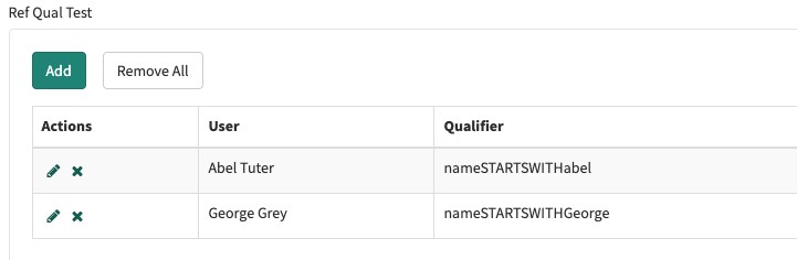

It's a bit ugly, but you can do it - you have to add a variable to MRVS to hold the value of the variable from your item and set it onload of the MRVS. You can make the field on the MRVS read-only and hidden, but it will still show the value in the list of rows.
My very simplified example:
Variable on the item
Variables in my MRVS
My onload script for the MRVS
function onLoad() {
g_form.setValue('qualifier', g_service_catalog.parent.getValue('reference_qualifier'));
Load the form and type in a Reference Qualifier
click add - only option is Abel Tuter.
change it up and try again
But as you can see, there is that pesky Qualifier field in the list.
You could probably blank out the value with an onsbumit script in the MRVS, but the field will still be there.
I hope this helps!
