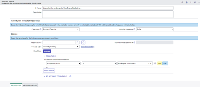

I have now tried to re-create your scenario in my PDI without any issues.
First, to duplicate your requirement, I have made the indicator source and automated indicator for collection of alle records assigned to "App Engine Studio Users". As you see below there is 10 records in my PDI.
The Indicator Source is created as below, where following settings has been set:
Facts table: Incident
Conditions: App Engine Studio Users
Afterwards I created a automated indicator with below conditions:
Indicator Source: data collection on demand of App Engine Studio Users

Ok for testing remove all of your breakdowns and then run the collection job to see what the count is.
Also you posted what you Indicator is setup for but not the Indicator Source. It looks like its set to "Incidents" but l'm not seeing a screen shot for it.

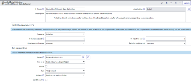

06-11-2023 11:25 PM
Still missing the screenshot of the indicator source? Also, according to your scheduled job, this is run on-demand and only for one day? is this correct?
