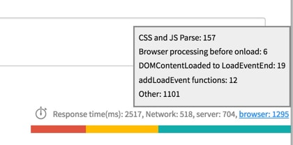

Anyway, use the response time indicator on the form to help diagnose where the time is coming from. It's that little clock that nobody ever seems to notice in the lower right corner. Click it once it provides some detail. Click the browser link and you get details about what is going on client side.
Response Time Indicator - ServiceNow Wiki
Troubleshooting Performance - ServiceNow Wiki

I investigated it further and on my production instance the server takes appx. 100 seconds (!!!) in response time while network and browser only takes 42 ms and 1473ms. Then I tried to use the same record producer on my test instance and that only takes about 3-4 seconds in response time. But how can I debug what's taking all this time on my production instance ?
I think I'll contact servicenow support in order to get their help. Thanks
