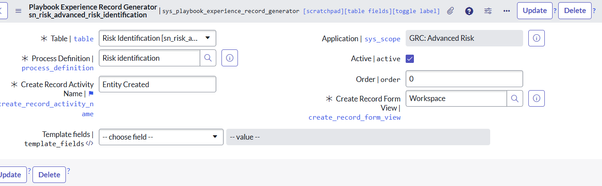

To get the record generator id, we need to create a Playbook Record Generator
Steps:
1. Navigate to playbook record generator.
Playbook record generator - Official documentation

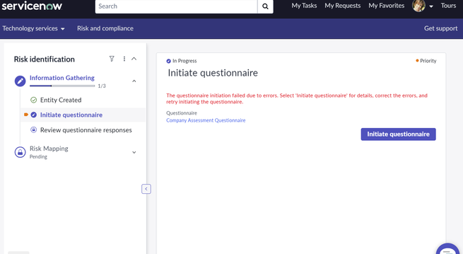

Now putting them all together, you can now render the playbook in portal.

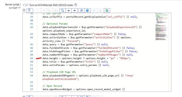

Do you know if it is possible to make the iframe height dynamic based on the playbook content, or do we need to manually set a fixed height?
Hi @Hanna_G , you can dynamically adjust the height but based on playbook content, i believe no or at least i haven't figured out yet.
The oob playbook widget accepts height as option.
Hope this helps.
