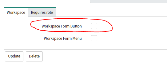

Also I am presuming the button is appearing in Workspace and you have the Workspace Form Button filed checked

Yes, the function is mentioned as 'onClick();' and Work Space from button is checked but still the UI action is not working.
