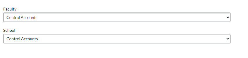

Hope you can help.  I am building a catalog item and need 2 reference variable to link to each other.
Variable 1 Faculty which a lookup select box referenced to a custom faculty table.
Variable 2 School also needs to be a lookup select box referencing the custom school table.
The custom school table has a parent field that links to the Faculty table.
So I need the school variable to only show the records in the school table that have a parent of the option chosen in the faculty variable.
I have posted a picture of the simple form so far. How do I achieve this?  many Thanks
