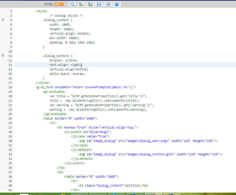

Step 2 : The UI page design in UI Pages module :
NOTE : The Name of the UI page you are about to design should be given same as the name you have passed as a parameter here var dialog = new GlideDialogWindow('glide_confirm_standard'); Means here my UI page name should be "glide_confirm_standard".
Open a New UI page to design. My code goes like this (in the HTML box) :
Code continued in the below screen shot :
What you can do is : Check for other UI pages in your instance and just copy & paste the HTML script here in your new UI Page and then just edit according to your needs.
