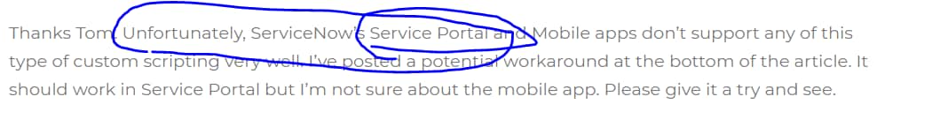

Apparently that doesnt work too (I have actually tried that as my first option).  And this is what the author says in the article:
