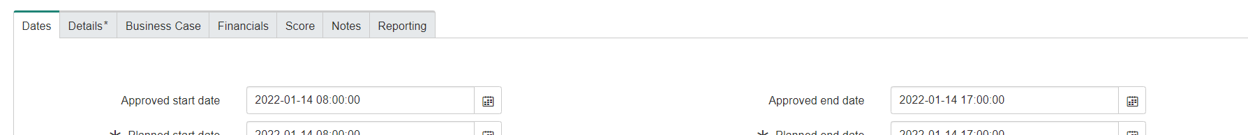

For the third one I can show you the difference using screenshots from my instance
Project:-
Subproject:-
Also can you mark my answer as correct as i gave answer to all 6 whereas Anurag only to 4 of them.
