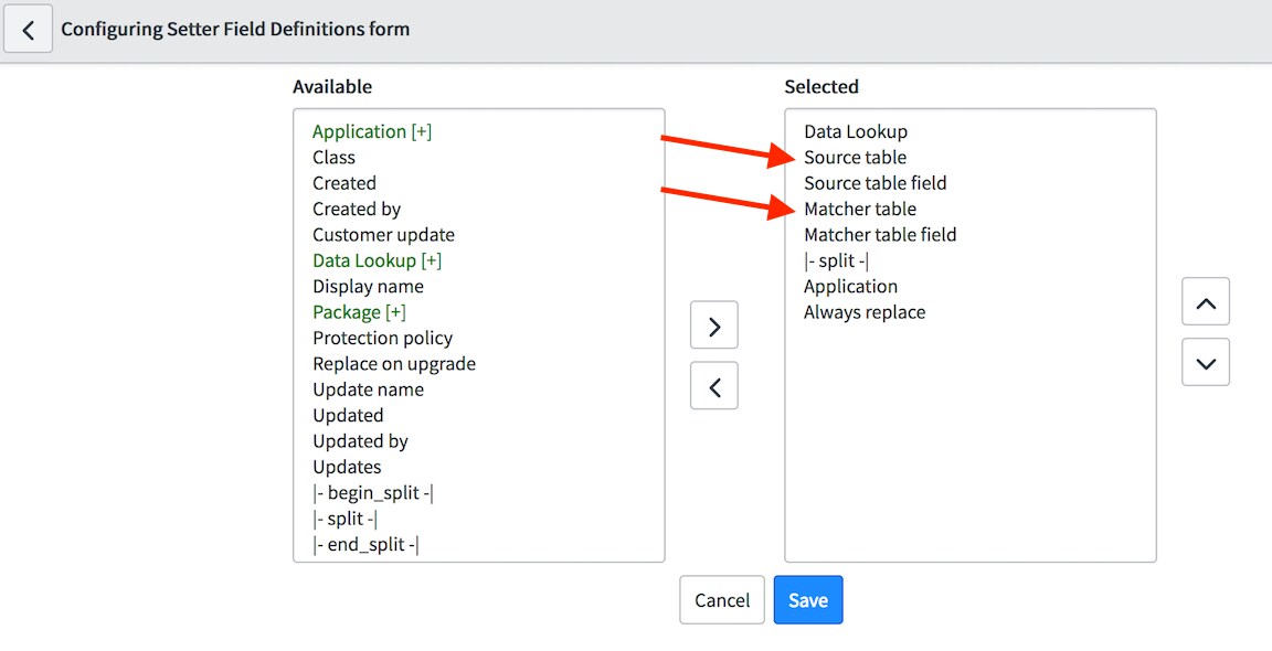

You have to add Source table & Matcher table fields to the form:
Hi Michael.Fry
The fields were already added to the form (they were just hidden).
