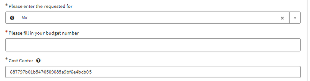

my goal is to display the cost center of the current requested for automatically in the Service Portal.
Therefore, I map the field cost_centers_clock (reference field) with the cost_center field from the user record in a client script:
How can I convert the sys_id into the name?

I have found several solutions, but they have not worked for me.
g_form.setValue('cost_centers_clock', gr.getDispayValue('cost_center'));
g_form.setValue('cost_centers_clock', gr.getDispayValue('cost_center.name'));
gr.cost_centers_clock.getDisplayValue()
// Use of GlideAjax...
Can anyone help me?
Thanks in advance!
