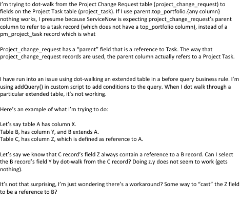

For those coming to this thread, I share here how I managed to do this after having struggled a bit.
This is the working version of the piece of code using a filter to a child table access through a reference table attribute:
The tricky part was in line 43.
I wanted to get the list of IP Addresses in use for the Configuration Item that are not retired nor stolen. In other words, any IP Address in use. However, the Hardware Status attribute is not part of the cmdb_ci class, but it's only added to the cmdb_ci_hardware class (child of cmdb_ci).
As mentionned earlier by @benedwards, the trick is to access the child table by adding the "_ref" prefix. However, I struggled anyway to find the right filter in my case.
So I finally found it by going to the cmdb_ci_ip_address table and adding a filter and browing through the attributes to find the path to the field I wanted to filter on (it's quite convenient):
After running it, I could see the query in the browser address or could also copy it by right-clicking the filter link and selecting the copy query menu:
Hope this will help someone 🙂
