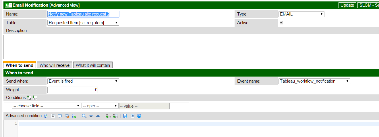

Can you paste a screenshot of the notification ?
02-13-2015 06:11 AM
Hi
files attached
Event is the event registry
notification is the notification
processed is the one that is failing - it as sc_req_item as the table
processed2 is the one that works, - nothing in the table field
