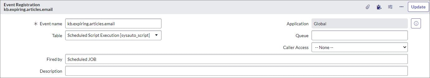

1) Go to "System Policy" > "Events" > "Registry" in the system and register a new event.
