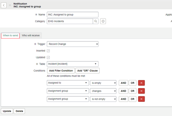

I have no idea what the issue here might be, but we started setting up provider notifications (to get rid of mails for our agents) and all of them are working fine when they'll be send to one user (e.g. mentioned by, additional comment/work note added to record etc).
What we now want to have is the simple notification when a new record arrives in one of their groups but is unattended. I used the exact same parameter as for our email notification, and added "Recipients listed in field" > Assignment Group.
Content Class is set to Next Experience.
However, no notification is to be shown by the bell. The trigger is somehow successfully working it seems, as far as I can see in the log.

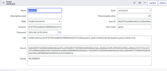

The event log looks like this when triggered:
(note all the user sys_ids, comma separated in parm1).

However, I tried it with using an event today and just couldn't get it to work. Business Rule fires the event, I can see that much, but whatever I add to param in the script, also whatever I try to filter there, in the event log I can see that the event literally ALWAYS return
Parm1
Old Assignment Group
Parm 2
New Assignment Group
expect i hardcode what shall be in there. I am getting insane, why does the provider notifs not work out like the normal ones? The normal ones get all assignment group members just fine...
Looking at the logs above it looks to be working
