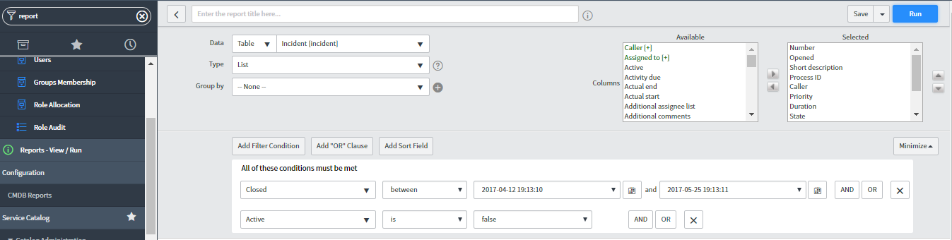

I tried filtering on table , by adding filters as you have suggested but it doesn't fetch the desired output .
i had tried with closed 'at or after' '2017-04-12 19:00:00' but it didn't fetch record closed at '2017-04-12 19:13:11'
Monica

Hi Shihir,
Thanks for your reply.
But it didn't work.I tried filtering on table , by adding filters as you have suggested but it doesn't fetch the desired output .
i had tried with closed 'at or after' '2017-04-12 19:00:00' but it didn't fetch record closed at '2017-04-12 19:13:11'.
It seems at or after is not working as expected.Whereas 'at or before' works perfectly fine.
Monica
