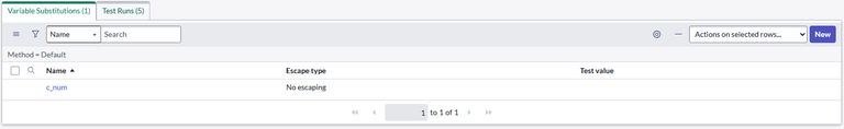

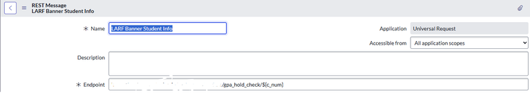

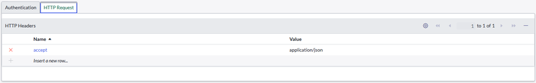

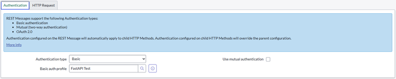

Thank you for the reply!  Unfortunately, both methods return Error: Received non-successful HTTP status code: 0, suggesting the REST API call is not even reaching the server or the response is being blocked in some way.  I can successfully return a JSON string when I use variable substitution to test the REST, but no response trying to pass the c_num field as an http parameter client-side.
Here are my settings for the REST config:
I am using the mid-server for authentication on the Default GET.
